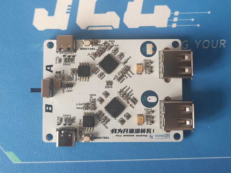

这是一个用于两台电脑共享一套键盘鼠标的小东西,移动鼠标,键鼠就可以在两台电脑间自由切换,相当丝滑!基于Git上一个开源作品重新设计了PCB板,更小巧简洁,测试功能完全没有问题!
简介:这是一个用于两台电脑共享一套键盘鼠标的小东西,移动鼠标,键鼠就可以在两台电脑间自由切换,相当丝滑!基于Git上一个开源作品重新设计了PCB板,更小巧简洁,测试功能完全没有问题!
创建时间:2024-04-12 00:46:27更新时间:2024-08-19 10:03:41
原作Git链接:https://github.com/hrvach/deskhop
我只重新设计了PCB,开源软件还用原作者的!
已测试有线鼠标,2.4G无线鼠标支持都没问题,蓝牙鼠标不支持!键盘测试了我自制的机械键盘和普通有线键盘,自制键盘有线模式没问题,蓝牙模式则不支持,有线键盘我有一款Dell的键盘也不行,插入一直输入空格键不知道什么原因!
操作系统测试了Win10 Win7 WinXP和纯国产电脑龙芯CPU操作系统为中标麒麟,都没有问题,测试见附件两个视频!
使用方法:
1.刷入固件方法:开关拨到A,插入电脑,电脑会出现个U盘,将board_A.uf2文件复制到新出现的RP U盘中!
                            开关拨到B,插入电脑,电脑会出现个U盘,将board_B.uf2文件复制到新出现的RP U盘中!
2.使用:放置在左边的电脑使用type-c线插入B接口,右边的电脑则插入A接口,开关随便拨到A或B都可以,拨到哪里整个器件和键盘鼠标就由哪台电脑供电!鼠标从B电脑的右边再往右移就会出现在A电脑的屏幕中,此时键盘鼠标就对A电脑起作用;反之,从A电脑左边往左移就会出现在B电脑屏幕,此时键鼠作用于A电脑!

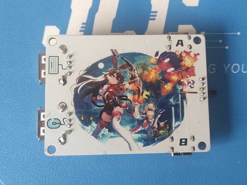

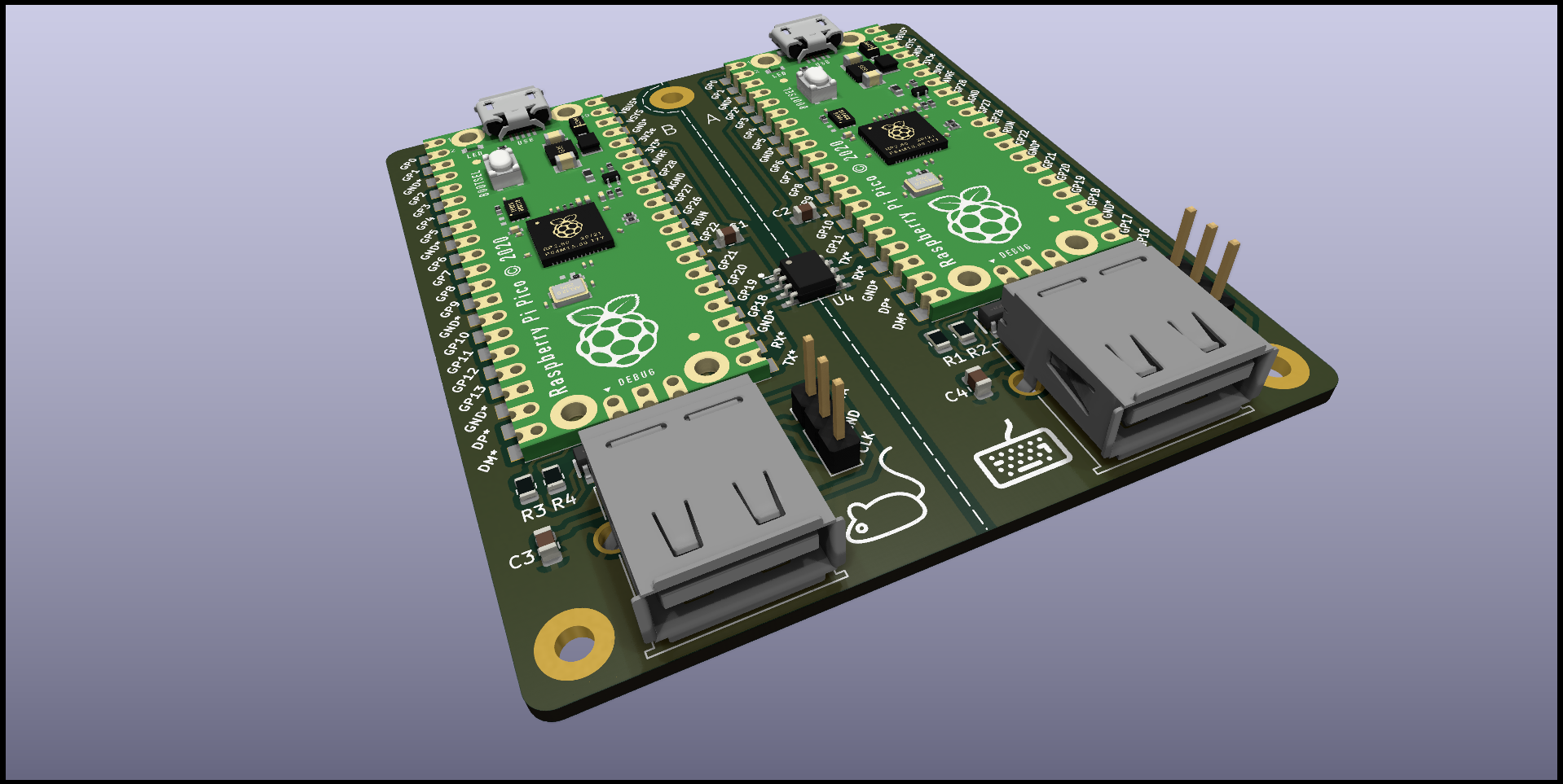

原作PCB:用的是两块Pico开发板设计的底板!
我的PCB:基于两颗RP2040芯片设计,小巧优雅多了!

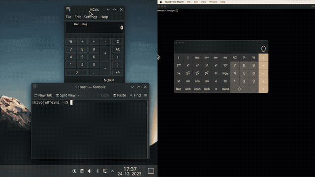

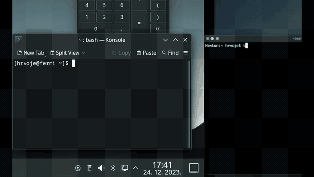

Mouse
To get the mouse cursor to magically jump across, the mouse hid report descriptor was changed to use absolute coordinates and then the mouse reports (that still come in relative movements) accumulate internally, keeping the accurate tally on the position.
When you try to leave the monitor area in the direction of the other monitor, it keeps the Y coordinate and swaps the maximum X for a minimum X, then flips the outputs. This ensures that the cursor seamlessly appears at the same height on the other monitor, enhancing the perception of a smooth transition.
Dragging the mouse from Mac to Linux automatically switches outputs.
The actual switch happens at the very moment when one arrow stops moving and the other one starts.

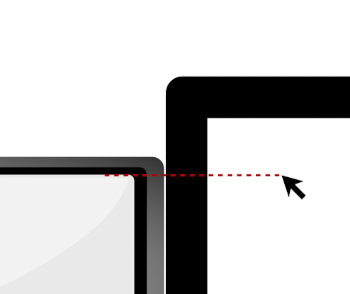

Switch cursor height calibration
This step is not required, but it can be handy if your screens are not perfectly aligned or differ in size. The objective is to have the mouse pointer come out at exactly the same height.
Just park your mouse on the LARGER screen at the height of the smaller/lower screen (illustrated) and press Right Shift + F12 + Y. Your LED (and caps lock) should flash in confirmation.
Repeat for the bottom border (if it's above the larger screen's border). This will get saved to flash and it should keep this calibration value from now on.
