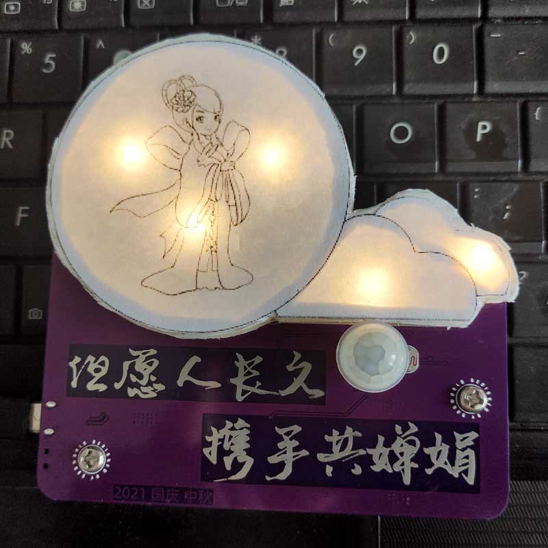

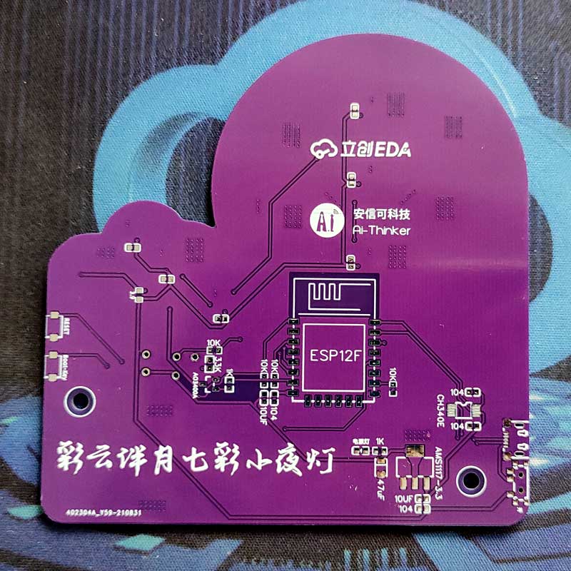

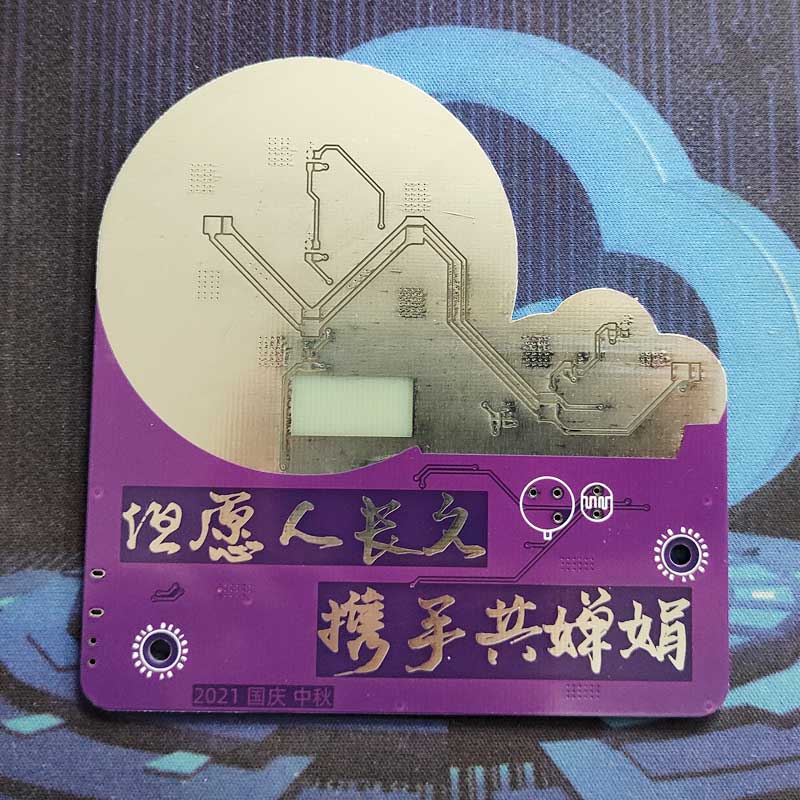

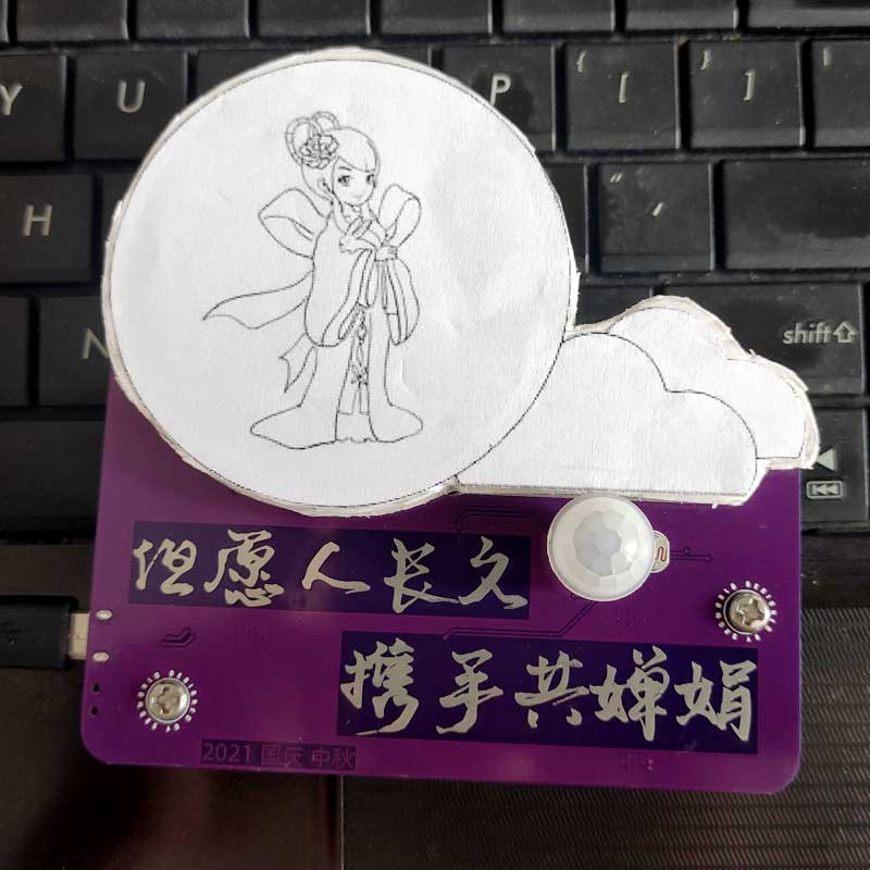

简介:彩云伴月七彩小夜灯,主控使用使用ESP-12F,五颗暖光LED灯珠实现夜灯照明功能;六颗WS2812B实现彩云追月和七彩模式功能;人体感应使用AS312,光敏电阻感应光线。
开源协议: GPL 3.0
1 | 10UF | C1,C2 | C0603 | 2 |
2 | 104 | C3,C4,C5,C6,C8,C9,C10,C11,C12,C13 | C0603 | 10 |
3 | 47uF | C7 | CAP-SMD_L3.2-W1.6 | 1 |
4 | AS312 | CGQ1 | SENSORM-TH_3P_AS312 | 1 |
5 | SLP短接点 | JP2 | 2P短接点 | 1 |
6 | 电源灯 | LED1 | LED0603_RED | 1 |
7 | WS2812B-2020 | LED2,LED3,LED4,LED5,LED6,LED8 | LED-SMD_4P-L2.0-W2.0-TL_WS2812B-2020 | 6 |
8 | HL-AM-2835D1W-S1-08-HR3_C210320 | LED9,LED10,LED11,LED12,LED13 | LED-SMD_L3.3-W2.8-RD | 5 |
9 | AO3400A | Q2 | SOT-23-3_L2.9-W1.6-P1.90-LS2.8-BR | 1 |
10 | 1K | R1,R9 | R0603 | 2 |
11 | 10K | R2,R3,R4,R5 | R0603 | 4 |
12 | 33K | R6 | R0603 | 1 |
13 | GL5528 | R7 | RES-TH_L5.1-W4.3-P3.40-D0.5 | 1 |
14 | 3.9 | R11 | R0603 | 1 |
15 | RESET | SW1 | SW-SMD_L3.9-W3.0-P4.45 | 1 |
16 | ESP电源 | SW2 | SW-TH_K3-1296S-E1 | 1 |
17 | Boot-Key | SW3 | SW-SMD_L3.9-W3.0-P4.45 | 1 |
18 | M3铜柱 | TP1,TP2 | M3铜柱 | 2 |
19 | AMS1117-3.3 | U1 | SOT-223-3_L6.5-W3.4-P2.30-LS7.0-BR | 1 |
20 | CH340E | U2 | MSOP-10 | 1 |
21 | ESP-12F(ESP8266MOD) | U3 | WIFIM-SMD_ESP-12F-ESP8266MOD | 1 |
22 | U-F-M5DS-Y-8 | USB1 | MICRO-USB-SMD_U-F-M5DS-Y-8 | 1 |
