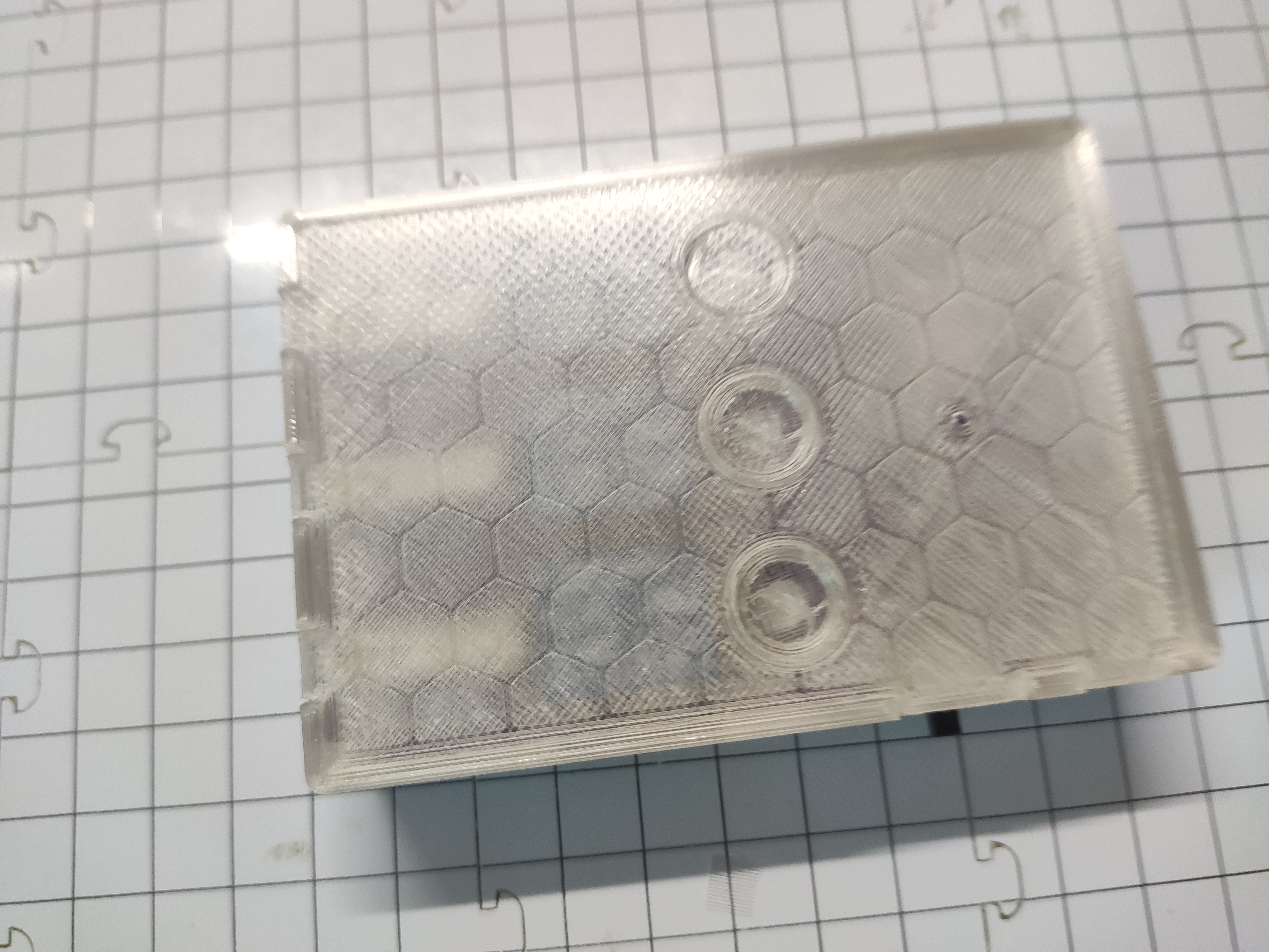

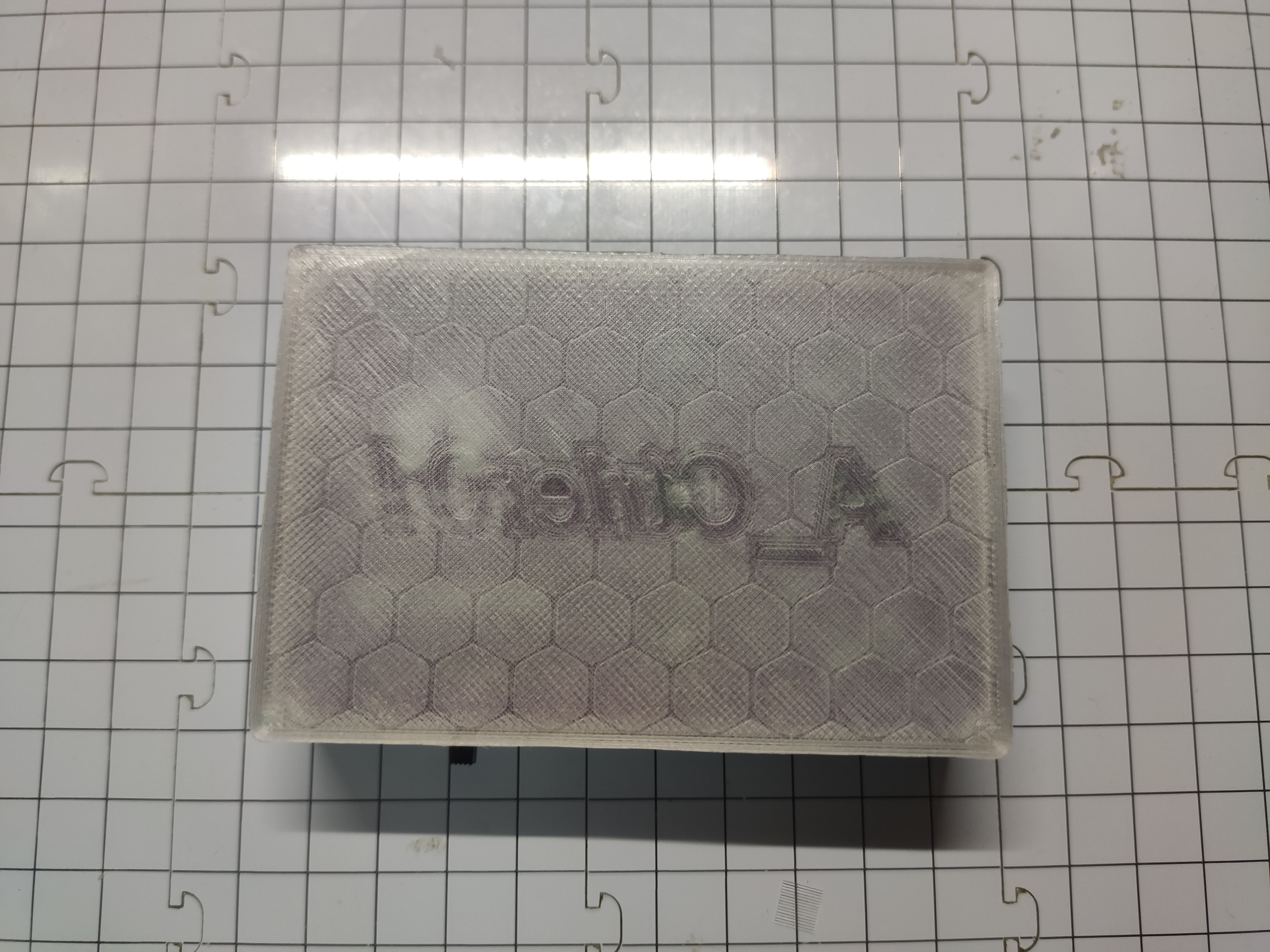

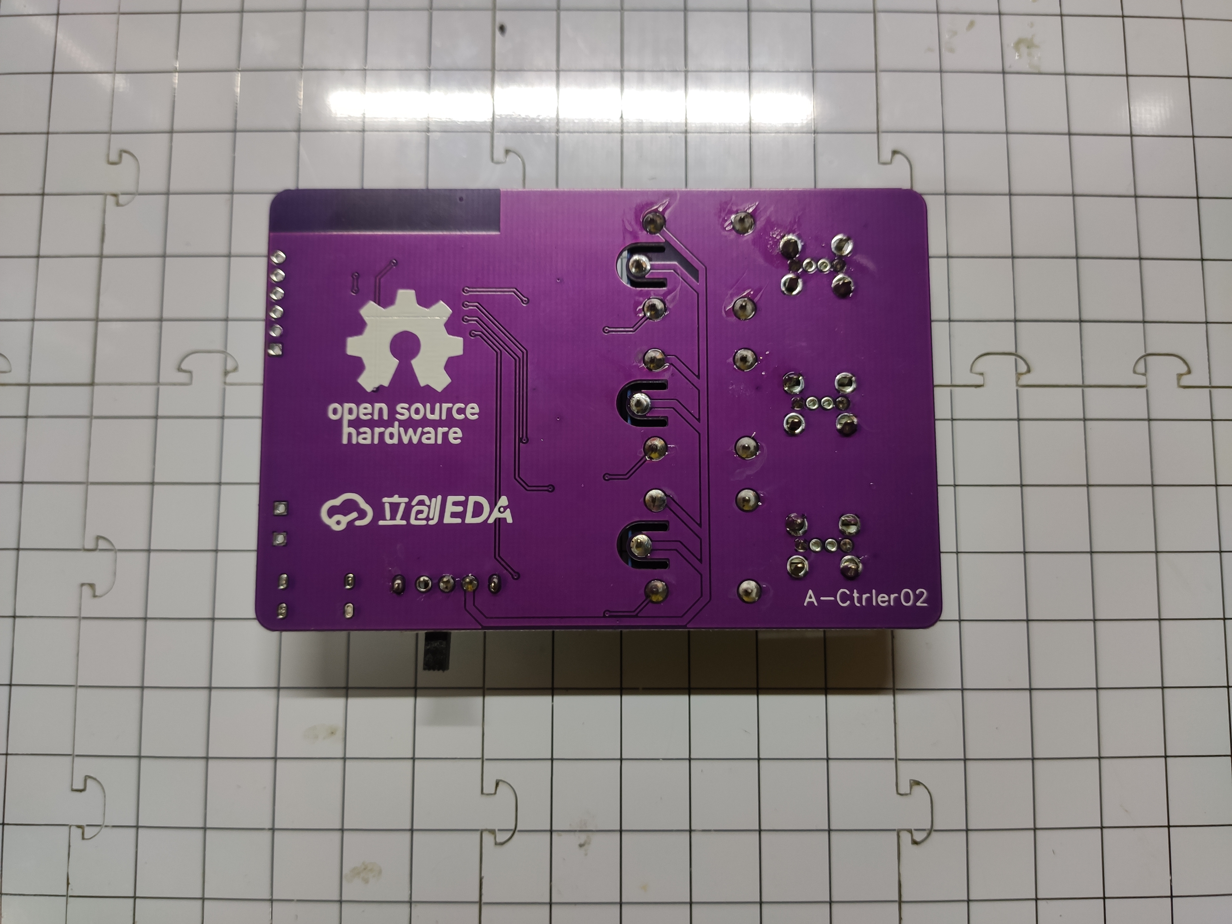

简介:WiFi桌面设备控制器,用于管理桌面台灯,风扇等小型设备,硬件已验证,本地按键模式也没问题,接下来试试做个app
开源协议: GPL 3.0
1 | HDR-M-2.54_1x1 | +,- | HDR-M-2.54_1X1 | 2 |
2 | 100nf | C1,C7,C8 | C0603 | 3 |
3 | 10uf | C2,C6,C9 | C0603 | 3 |
4 | 0.1u | C3,C4,C5,C10 | C0603 | 4 |
5 | 1N4148WS-13-F | D1,D2,D3 | 1N4148W T4 | 3 |
6 | HDR-F-2.54_1x6 | H1 | HDR-F-2.54_1X6 | 1 |
7 | K2-3.6×6.1_SMD | KEY1,KEY2,KEY3,KEY4 | 按键 | 4 |
8 | S8050-HQ | Q1,Q2,Q3 | SOT-23-3_L2.9-W1.3-P1.90-LS2.4-BR | 3 |
9 | 4.7k | R1,R4,R6 | R0603 | 3 |
10 | 10k | R2,R3,R5,R7,R8,R9,R10,R11,R12,R13,R14 | R0603 | 11 |
11 | SRD-5VDC-SL-C | RELAY1,RELAY2,RELAY3 | RELAY-TH_SRD-XXVDC-XL-C | 3 |
12 | SK-12E12-G050 | SW1 | SW-TH_G-SWITCH_SK-12E12-G050 | 1 |
13 | ESP-12F(ESP8266MOD) | U1 | WIFIM-SMD_ESP-12F-ESP8266MOD | 1 |
14 | AMS1117-3.3 | U2 | SOT-223-3_L6.5-W3.4-P2.30-LS7.0-BR | 1 |
15 | USB-226-BRY | USB1,USB2,USB3 | USB-A-TH_USB-226-BRY | 3 |
16 | TYPEC-250D-BCP6 | USB4 | USB-C-SMD_TYPEC-250D-BCP6 | 1 |
