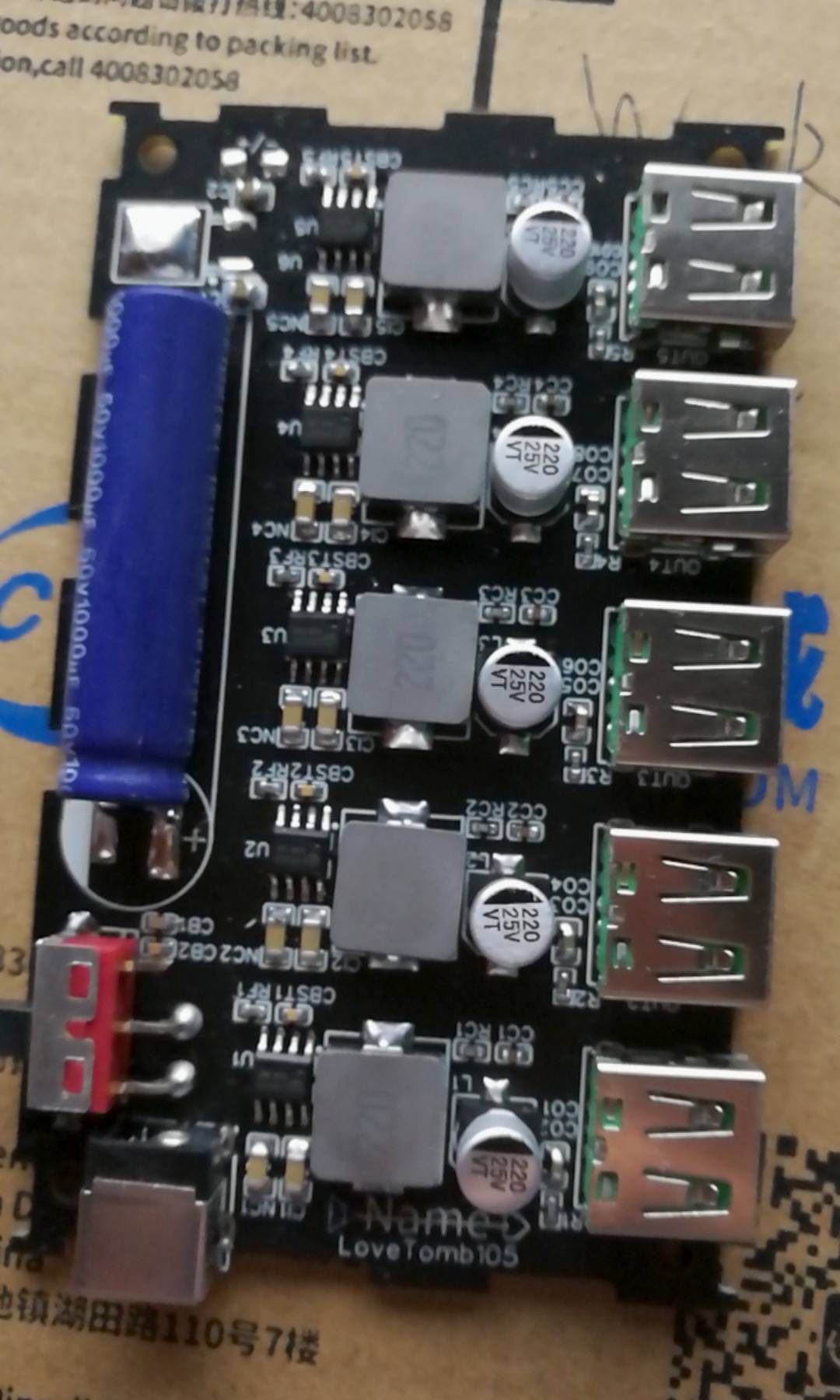

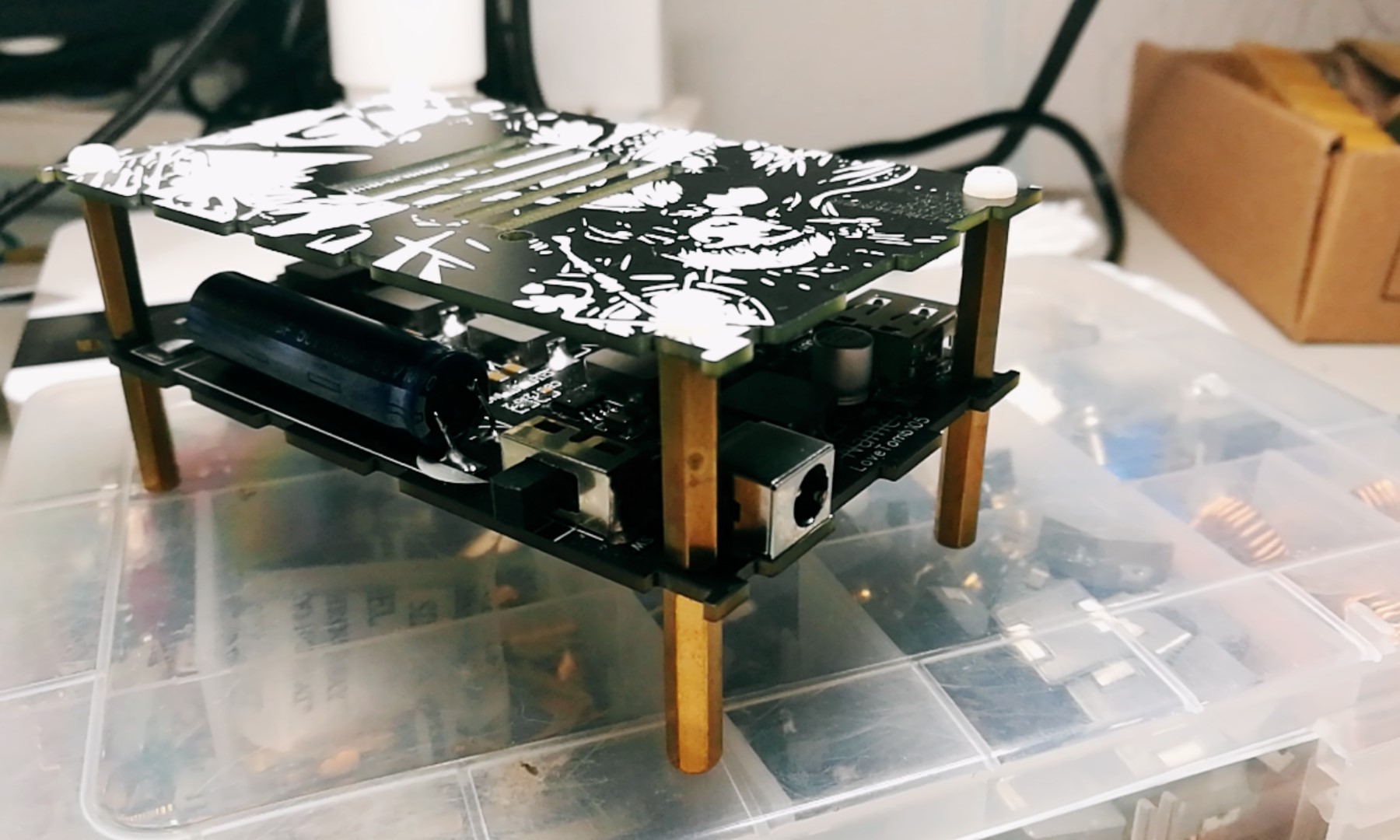

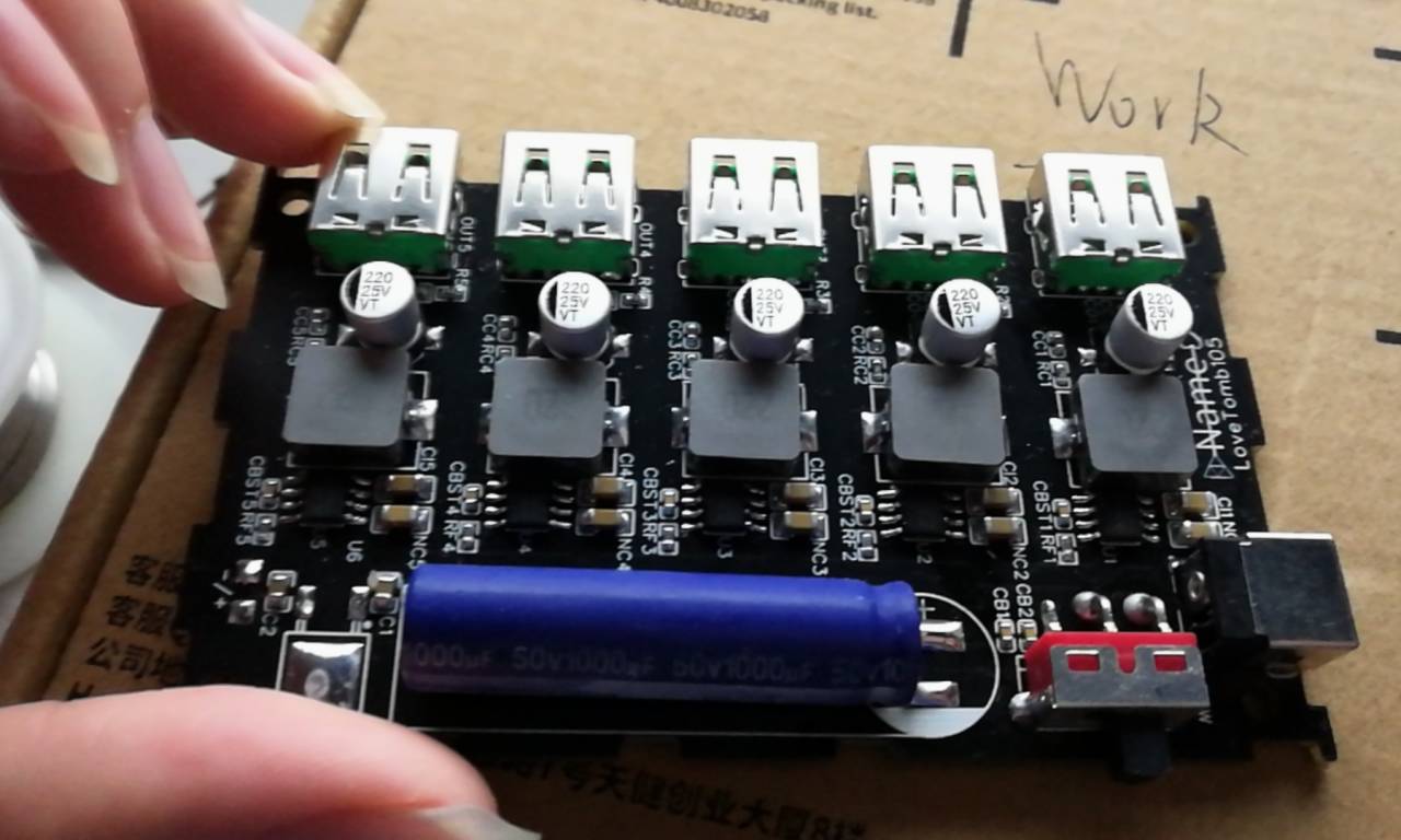

标准版 105 - 五路IP6505快充坞
简介:LoveTomb105,一份简单的IP6505充电器
开源协议: Public Domain
--输入电压35V以内,以DC044母座介入;
有一个大电流开关作为总开关,
输出电压3-12V间,输出电流4A以内;
各路独立输出,可分别同时输出不同的快充协议,对于那些双USB/三USB输出却使用同一条输出电路而无法同时快充的落后设计占更大优势;
输出功率100W最大;
ID | Name | Designator | Footprint | Quantity | Manufacturer Part | Manufacturer | Supplier | Contributor | JLCPCB Part Class | |
1 | 10uF | C1,C2,CO2,CO3,CO5,CO7,CO9 | C0805 | 7 | CL21A106KOQNNNE | SAMSUNG | LCSC | C1713 | CL21A106KOQNNNE | |
2 | 1000uF | C3 | CAP-TH_BD12.5-P5.00-D0.6-FD | 1 | KM108M050J25RR0VH2FP0 | CX(承兴) | LCSC | C18104 | 1000uF 50V | |
3 | 100nF | CB1,CBST1,CBST2,CBST3,CBST4,CBST5 | C0603 | 6 | CL10B104KB8NNNC | SAMSUNG | LCSC | C1591 | CL10B104KB8NNNC | |
4 | 1uF | CB2 | C0603 | 1 | UMK107AB7105KA-T | TAIYO YUDEN | LCSC | C105174 | UMK107AB7105KA-T | |
5 | 1nF | CC1,CC2,CC3,CC4,CC5 | C0603 | 5 | CL10B102KC8NNNC | SAMSUNG | LCSC | C153291 | CL10B102KC8NNNC | Extend |
6 | 22uF | CI1,CI2,CI3,CI4,CI5 | C1206 | 5 | C3216X5R1V226MTJ00E | TDK | LCSC | C342620 | C3216X5R1V226MTJ00E | |
7 | 220uF | CO1,CO4,CO6,CO8,CO10 | CAP-SMD_BD6.3-L6.6-W6.6-FD | 5 | VZT221M1ETR-0607 | Lelon | LCSC | C371974 | VZT221M1ETR-0607 | |
8 | DC-044B-3A-2.0 | DC2 | DC-IN-TH_DC-044B-3A-2.00 | 1 | DC-044B-3A-2.0 | XKB Connectivity(中国星坤) | LCSC | C388627 | DC-044B-3A-2.0 | |
9 | X6511WVS-02H-C60D48R2 | H1 | HDR-SMD_2P-P2.54_XKB_X6511WVS-02H-C60D48R2 | 1 | X6511WVS-02H-C60D48R2 | XKB Connectivity(中国星坤) | LCSC | C2883759 | X6511WVS-02H-C60D48R2 | |
10 | 22uH | L1,L2,L3,L4,L5 | IND-SMD_L11.5-W10.0_FXL1040 | 5 | YT1040-220M | Wenshan | LCSC | C428586 | YT1040-220M | |
11 | NC | NC1,NC2,NC3,NC4,NC5 | C1206 | 5 | C3216X5R1V226MTJ00E | TDK | LCSC | C342620 | C3216X5R1V226MTJ00E | |
12 | U234-051N-3GRA035-5 | OUT1,OUT2,OUT3,OUT4,OUT5 | USB-A-TH_U234-051N-3GRA03 | 5 | U234-051N-3GRA035-5 | XKB Enterprise | LCSC | C381138 | U234-051N-3GRA035-5 | |
13 | 3.3K | R1,R2,R3,R4,R5 | R0603 | 5 | 0603WAJ0332T5E | UniOhm | LCSC | C25995 | 0603WAJ0332T5E | |
14 | 2 | RC1,RC2,RC3,RC4,RC5 | R0603 | 5 | 0603WAJ020JT5E | UniOhm | LCSC | C25225 | 0603WAJ020JT5E | |
15 | 47K | RF1,RF2,RF3,RF4,RF5 | R0603 | 5 | 0603WAF4702T5E | UniOhm | LCSC | C25819 | 0603WAF4702T5E | Basic |
16 | SS-12D11L5 | SW1 | SW-TH_SS-12D11L5 | 1 | SS-12D11L5 | XKB Connectivity(中国星坤) | LCSC | C319010 | SS-12D11L5 | |
17 | IP6505 | U1,U2,U3,U4,U5 | SOIC-8_L5.0-W4.0-P1.27-LS6.0-BL-EP | 5 | IP6505 | INJOINIC | LCSC | C188335 | IP6505 | Extend |
18 | CJ7809 | U6 | TO-252-2_L6.5-W6.1-P4.58-LS10.0-TL | 1 | CJ7809 | Changjiang Electronics Tech (CJ) | LCSC | C177737 | CJ7809_C177737 | Extend |
