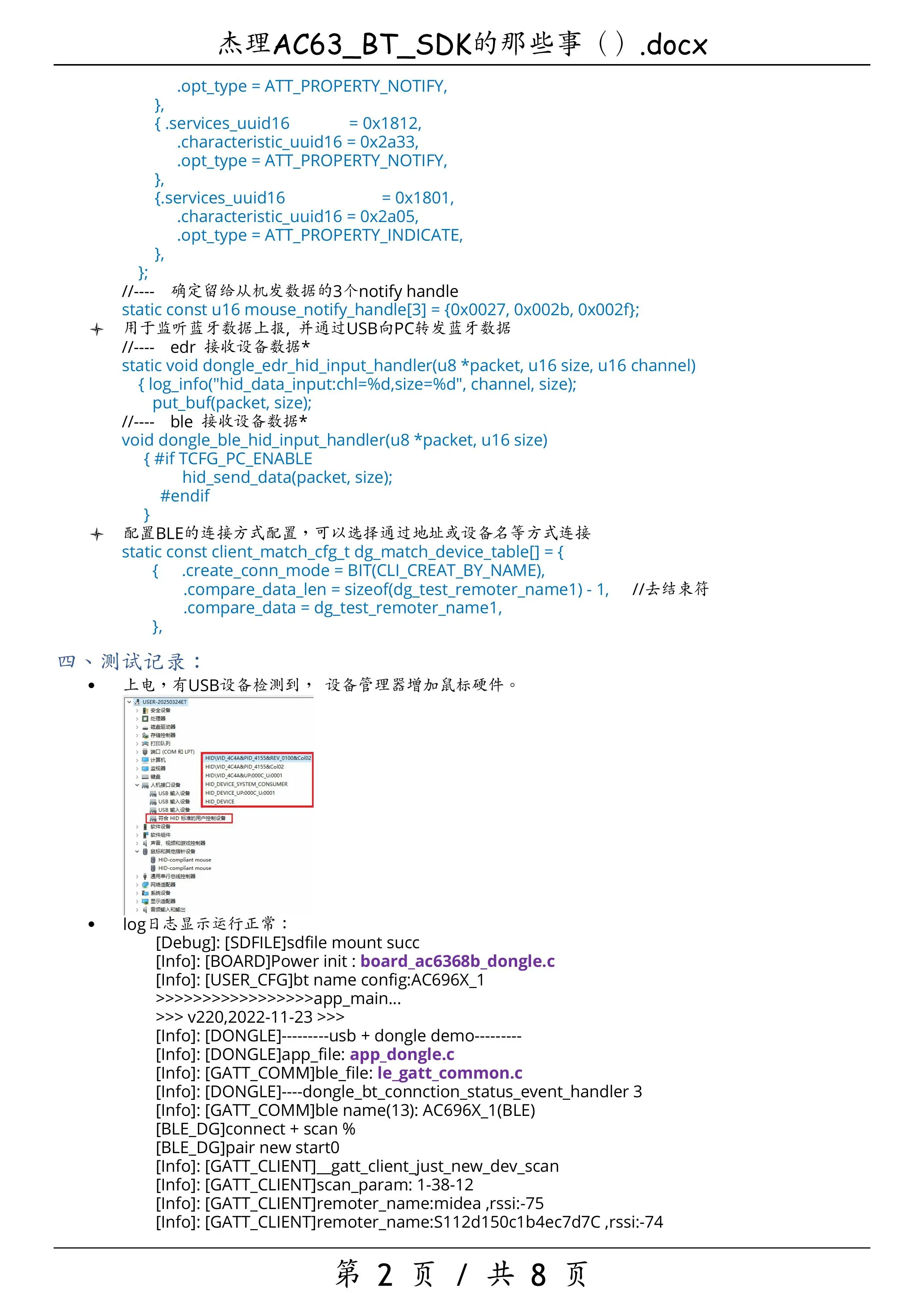

// USB → BLE 数据转发 (HID输出)
void dongle_hid_output_handler(u8 report_type, u8 report_id, u8 *packet, u16 size)
{   #if (TCFG_USER_EDR_ENABLE)
        edr_hid_data_send_ext(report_type, report_id, packet, size);
    #elif (TCFG_USER_BLE_ENABLE)
        ble_hid_data_send_ext(report_type, report_id, packet, size);
    #endif

// 匹配设备列表
static const client_match_cfg_t dg_match_device_table[] =
    {.create_conn_mode = BIT(CLI_CREAT_BY_NAME),  // 按名称匹配
        .compare_data_len = sizeof(dg_test_remoter_name1) - 1,
        .compare_data = dg_test_remoter_name1,       // "AC695X_1(BLE)"
        .filter_pdu_bitmap = 0,
        .compare_data_len = sizeof(dg_test_remoter_name2) - 1,
        .compare_data = dg_test_remoter_name2,       // "AC897N_MX(BLE)"
    { .create_conn_mode = BIT(CLI_CREAT_BY_TAG),   // 按自定义Tag匹配
        .compare_data_len = sizeof(user_config_tag_string) - 1,
        .compare_data = user_config_tag_string,      // "abc123"

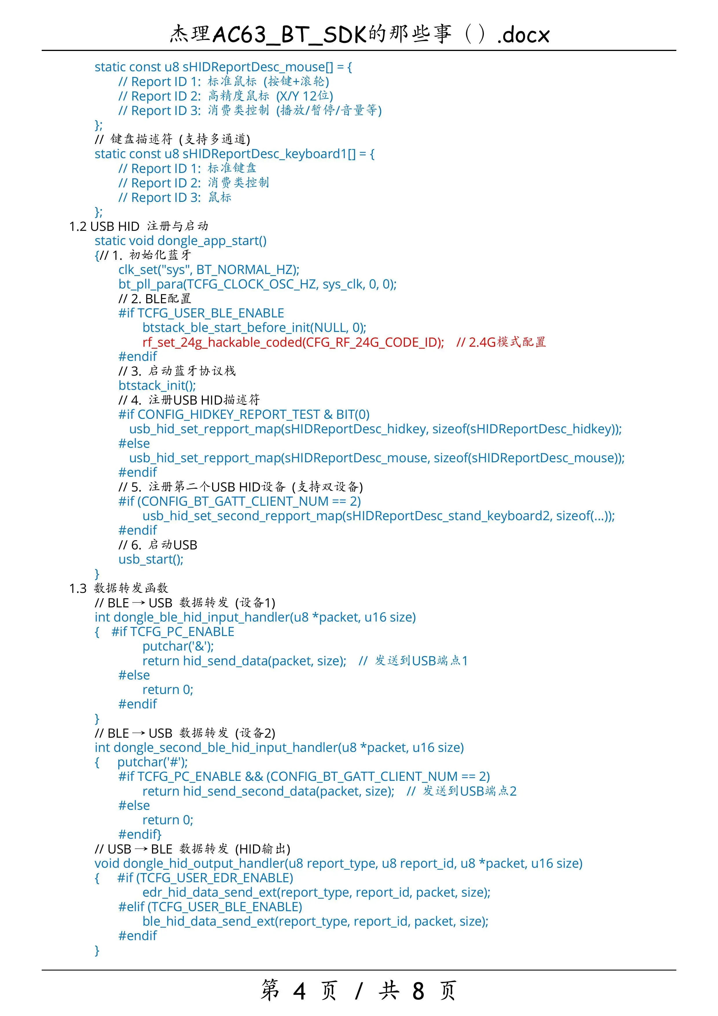

// USB挂起时,需要唤醒后再发送数据
static u8 wait_usb_wakeup = 1;
// 收到BLE数据时检查USB状态
if (usb_status_ret == USB_SUSPEND)
    wait_usb_wakeup = 0;
    usb_remote_wakeup(0);  // 发送远程唤醒
    break;
 else if (usb_status_ret == USB_RESUME_OK)     // USB已唤醒,正常发送
// 发送数据前检查
if (wait_usb_wakeup)
    memcpy(&usb_send_packet[1], report_data->blob, report_data->blob_length);
else     // USB未唤醒,发送空包(保持连接)
    memset(&usb_send_packet[1], 0                , report_data->blob_length);
