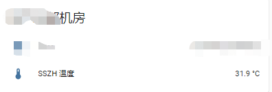

廉价测温方案及机房监控方案。直刷ESPHOME 固件,通过Homeassist,发送温度报警。

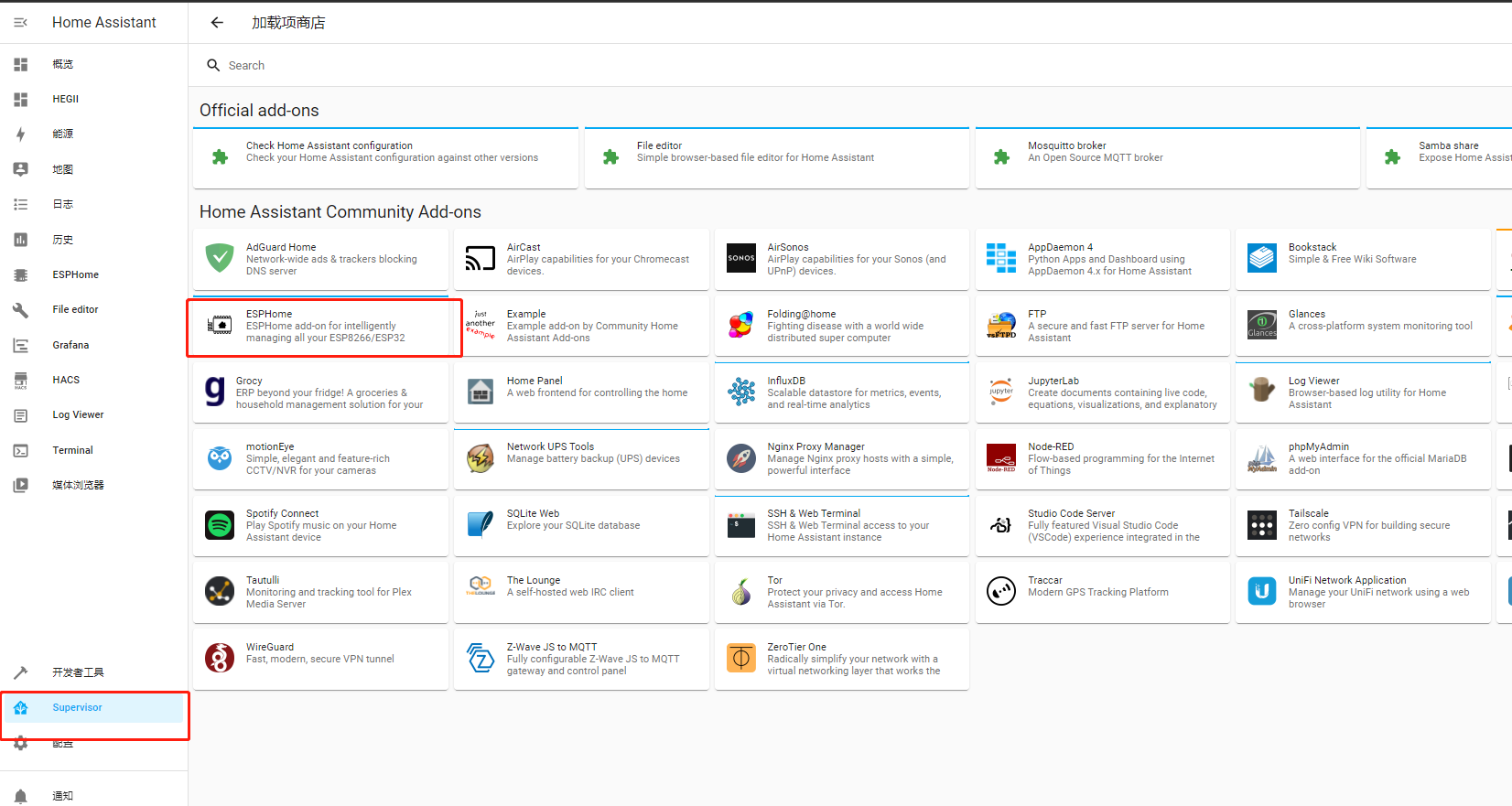

1. 用虚拟机安装HASSOS
   参考: https://www.home-assistant.io/installation/windows

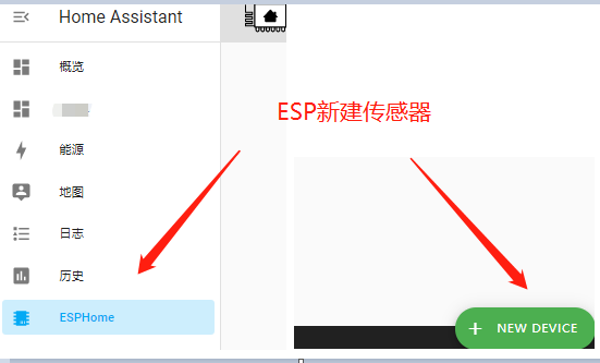

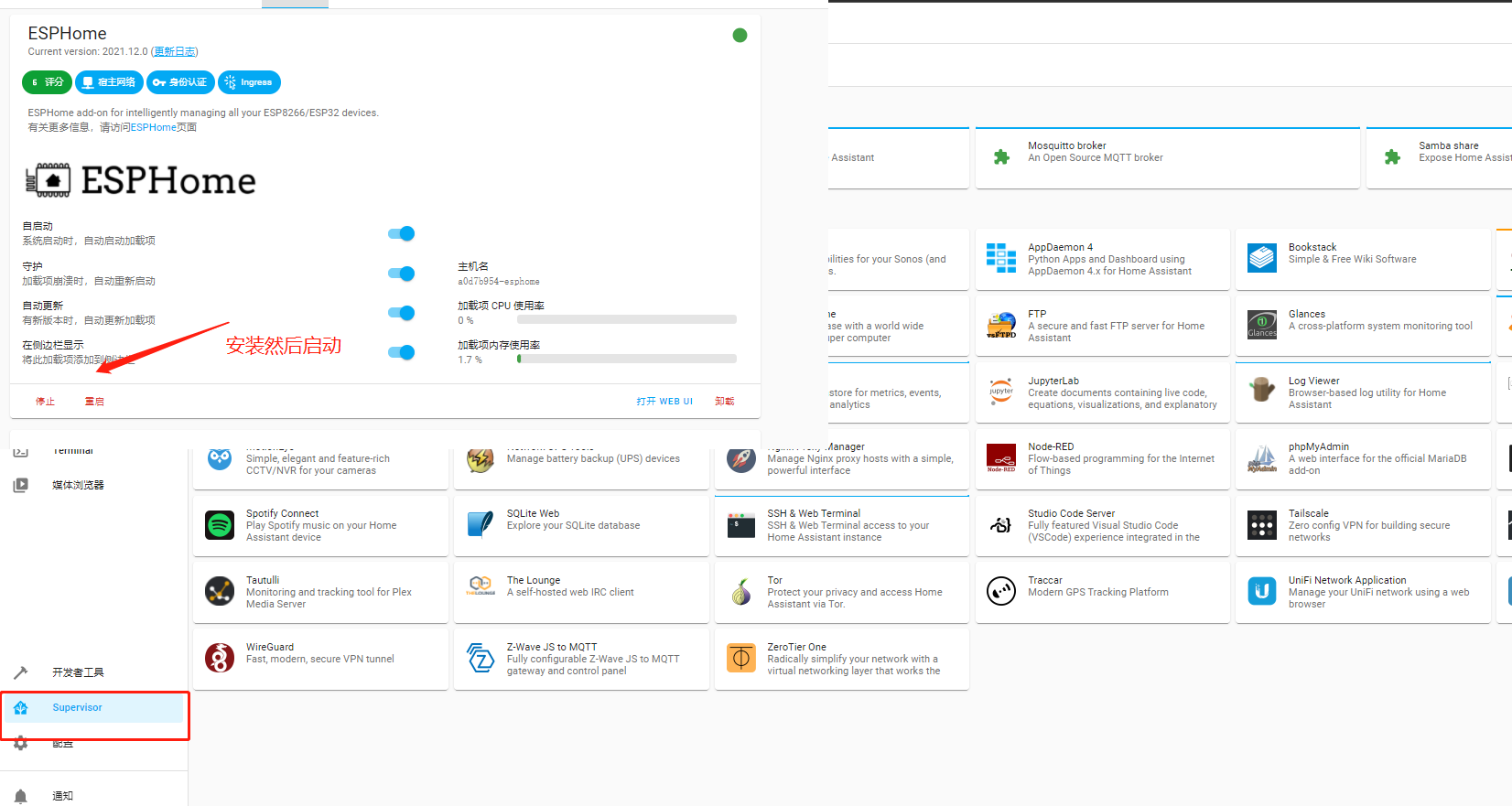

2. 在HASSOS上安装ESPHOME

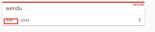

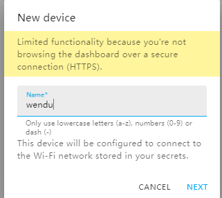

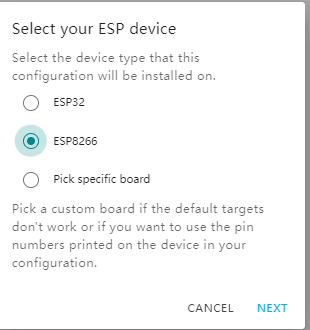

3. 在ESPHOME添加新建传感器

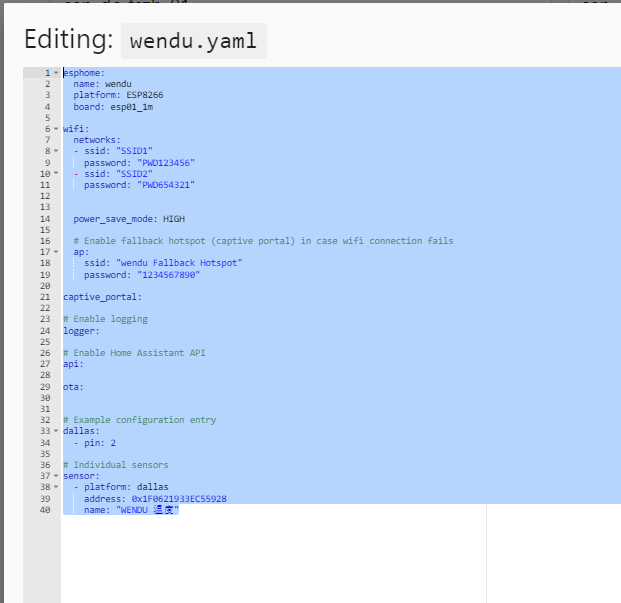

esphome:
platform: ESP8266
board: esp01_1m
wifi:
networks:
- ssid: "SSID1"
password: "PWD123456"
- ssid: "SSID2"
password: "PWD654321"
power_save_mode: HIGH
# Enable fallback hotspot (captive portal) in case wifi connection fails
ap:
ssid: "wendu Fallback Hotspot"
password: "1234567890"
captive_portal:
# Enable logging
logger:
# Enable Home Assistant API
api:
ota:
# Example configuration entry
dallas:
- pin: 2
# Individual sensors
sensor:
- platform: dallas
address: 0x1F0621933EC55928

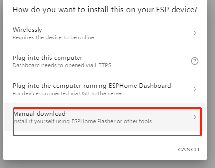

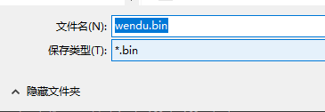

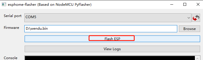

烧录软件: ESPHOME FLASHER
https://github.com/esphome/esphome-flasher/releases

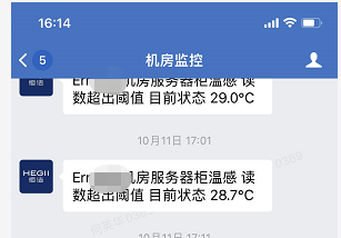

4. 编辑自动化发送企业微信报警
