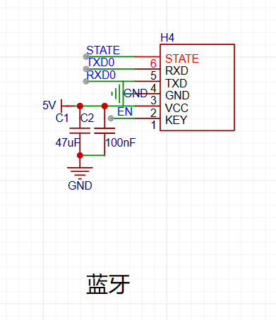

                  ⑤温湿度检测、LCD、人体感应、超声波测距、蜂鸣器、蓝牙透传模块
                    原理图如下,具体参见梁山派模块移植介绍:https://dri8c0qdfb.feishu.cn/wiki/JNDHwxPWWi99CJk6SkMc6Z3Yn2e?from=from_copylink
    wXBye3Zdh6z3IvjeyFaNGscbLwsSsuYxEYMEg1nq.pngmIkqPafDoJg5VyuABJkIPZ1ErM9tXP9bbG0CBkwP.png    as74bu4v5phLSsDQLghymk0ElqwppPhmCxqgRPC0.png       oJfAWVok8aZOQIbVdHZpkrIuvq9ZaLRlFp1KCkdK.png MyR3KaefZqmnA4wKYBSAz1kTf6OJDexcov0g928a.png iy7P79HCwMrQfYUxNEf17qKGvUw6eig3kFMRgJmE.png
