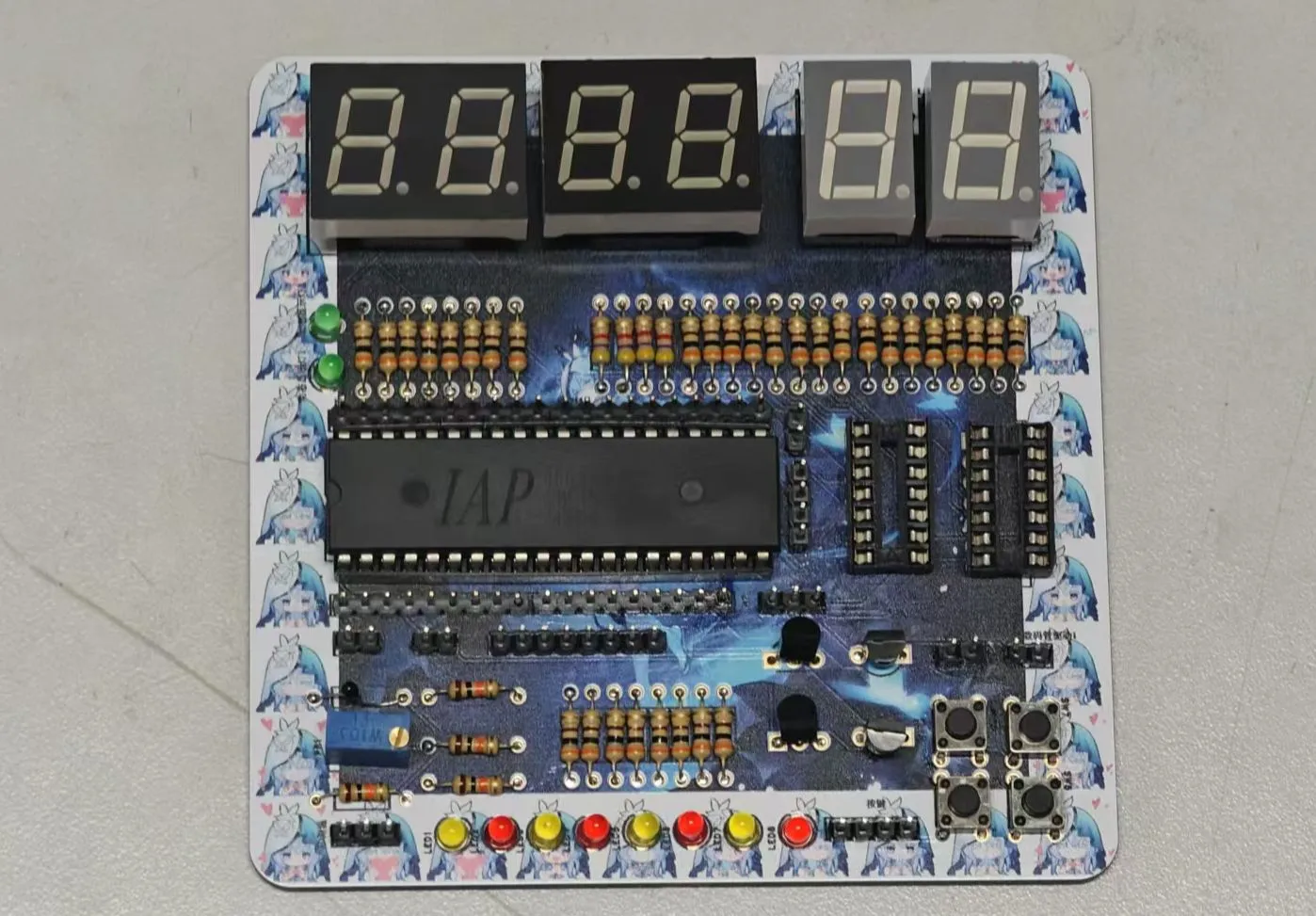

适合新手单片机入门,可进行流水灯、秒表计时器等基本调试运行
简介:适合新手单片机入门,可进行流水灯、秒表计时器等基本调试运行
彩色丝印征集令
创建时间:2024-11-07 23:19:56更新时间:2024-12-03 11:35:03
51单片机实验电路板

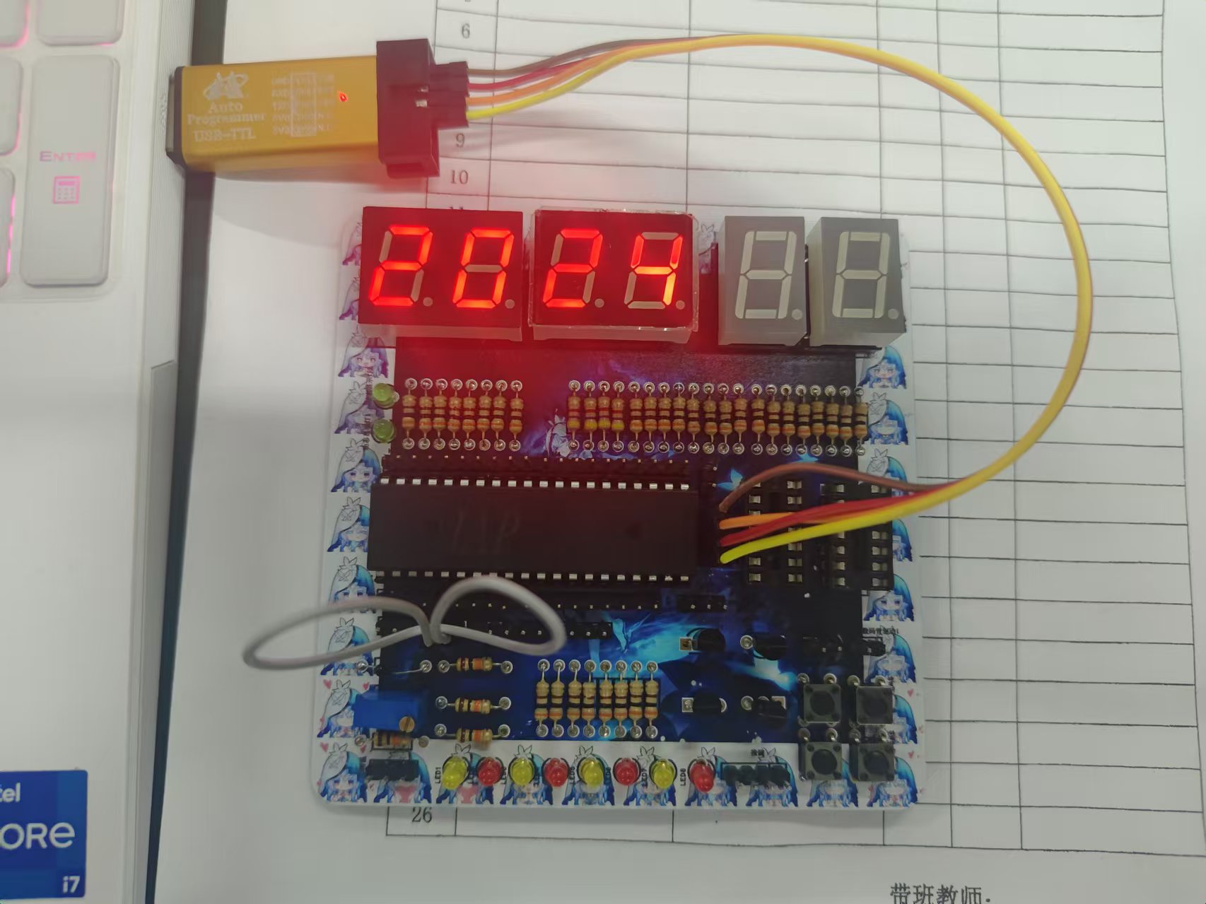

例1.动态显示
程序:
#include
#define XSS 10
#define XS P2
sbit M1=P3^4;
sbit M2=P3^5;
sbit M3=P3^6;
sbit M4=P3^7;
bit dtbz=0;
unsigned char SMXS[XSS]={0xC0,0xF9,0xA4,0xB0,0x99,0x92,0x82,0xF8,0x80,0x90};
void dscsh(void)
TMOD=0X90;
TH1=0Xfc;
TL1=0X18;
ET1=1;
EA=1;
TR1=1;
void t1zd(void) interrupt 3
TH1=0Xfc;
TL1=0X18;
dtbz=1;
void dtxs(void)
static unsigned char wx=0;
M1=1;
M2=1;
M3=1;
M4=1;
wx=wx+1;
if(wx>=5)
wx=1;
if(wx==1)
XS=SMXS[2];
M1=0;
M4=1;
if(wx==2)
XS=SMXS[0];
M2=0;
M1=1;
if(wx==3)
XS=SMXS[2];
M3=0;
M2=1;
if(wx==4)
XS=SMXS[4];
M4=0;
M3=1;
main()
dscsh();
while(1)
if(dtbz)
dtbz=0;
dtxs();
