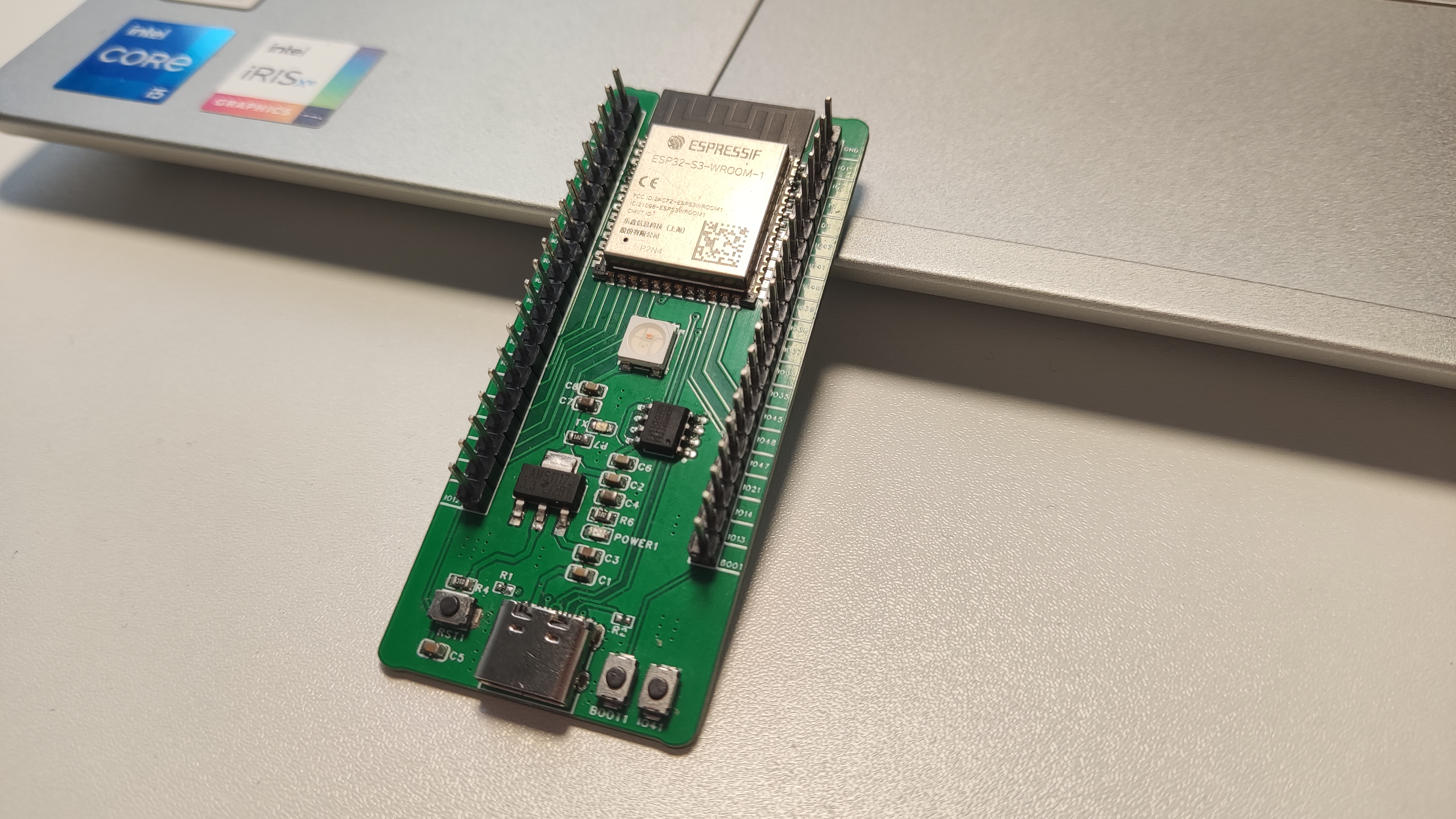

【单片机】基于ESP32 S3 WROOM-1的开发板
板载CH340N,可直接下载程序,一颗WS2812、一个IO独立按键

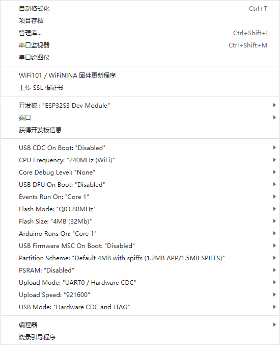

通过arduino 示例可简单点亮WS2812
#include "Freenove_WS2812_Lib_for_ESP32.h"
#define LEDS_COUNT  8
#define LEDS_PIN	11
#define CHANNEL		0
Freenove_ESP32_WS2812 strip = Freenove_ESP32_WS2812(LEDS_COUNT, LEDS_PIN, CHANNEL, TYPE_GRB);
void setup() {
  strip.begin();
  strip.setBrightness(20);
void loop() {
  for (int j = 0; j < 255; j += 2) {
    for (int i = 0; i < LEDS_COUNT; i++) {
      strip.setLedColorData(i, strip.Wheel((i * 256 / LEDS_COUNT + j) & 255));
    strip.show();
    delay(10);
