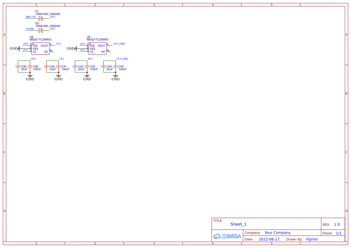

硬件芯片组:STM32F405RGT6(MCU),IMU1: ICM-42688P(双32kHz采样),IMU2: BMI270(内置硬件滤波),DPS310(超高精度气压计),128Mbit(16MB) NOR Flash,AT7456E(OSD)
DCDC(电源)芯片组:MP9943(DCDC,5V3A MAX),MP9943(DCDC,9V3A MAX),ME6215C33M5G * 2 (OSD芯片单独供电),图传VBAT LC 滤波(Max 3A)
连接器型号均为SH1.0 - xP,卧插Type-C
30.5 * 30.5标准空位,PCB大小:36 * 36
