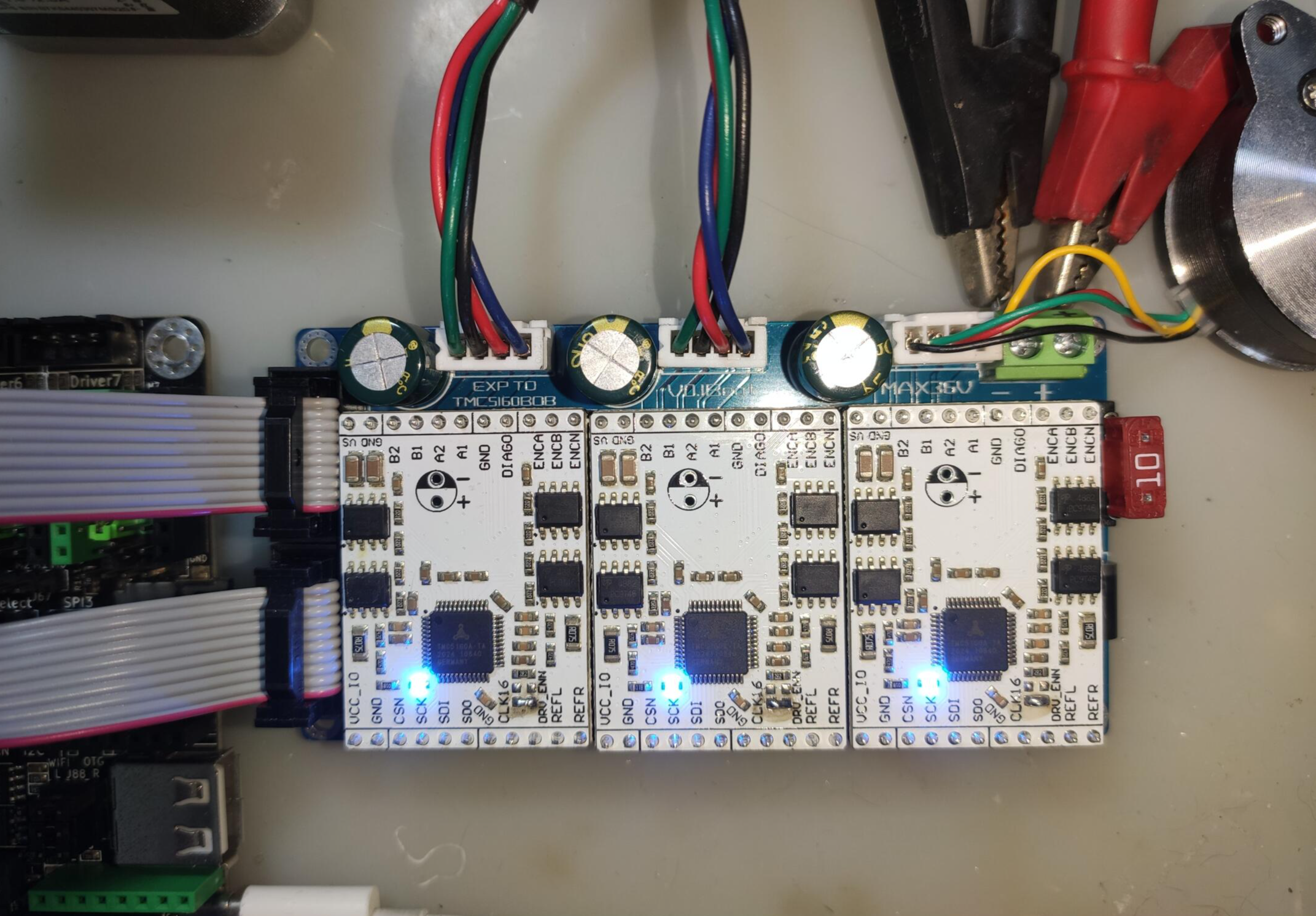

将空闲的EXP接口利用起来
简介:将空闲的EXP接口利用起来
创建时间:2024-12-07 21:37:52更新时间:2026-01-29 10:13:20

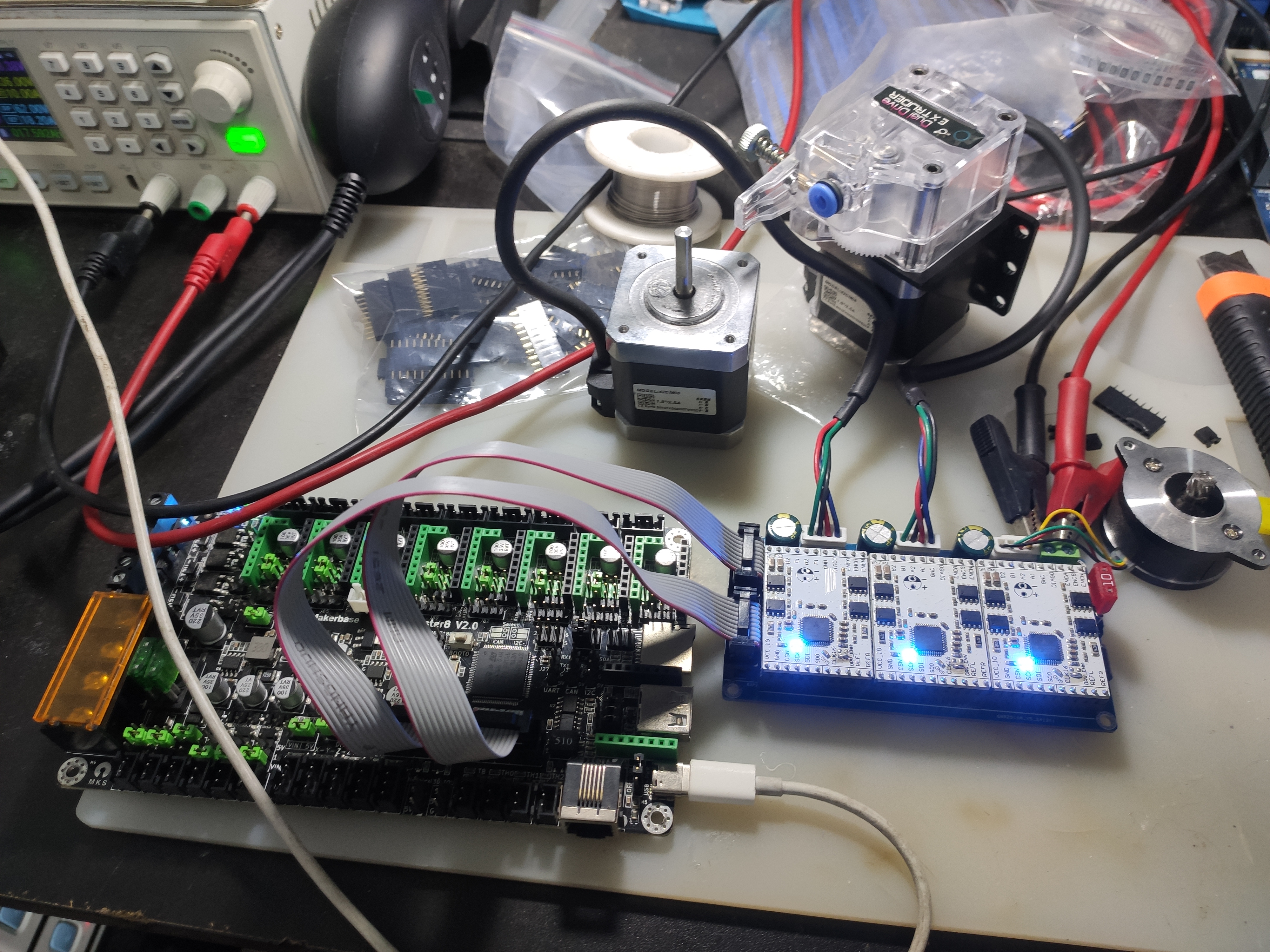

使用硬件SPI和独立UART
让空闲的EXP接口发挥作用
不用额外重新购买多轴主板或者多增加一块主板(主要目的)
可用于idex机型或者AWD机型使用
致MKS Monster8用户:由于该主板的EXP插槽缺口和另外两家朝向不一样,不知道是故意的还是不小心的,所以焊接时请也跟着反装接口。SPI1定义大家都是一样的,八爪鱼和Super8就正常按照丝印朝向焊接即可。
MKS Monster8:
[stepper_1]
enable_pin:!PE9
step_pin:PB11
dir_pin:PE8
[tmc5160 stepper_1]
cs_pin: PA4
spi_bus: spi1
interpolate: False
run_current: 4.4
sense_resistor: 0.075
#hold_current: 0.5
[stepper_2]
enable_pin:!PE15
step_pin:PE11
dir_pin:PD9
[tmc5160 stepper_2]
cs_pin: PB2
spi_bus: spi1
interpolate: False
run_current: 4.4
[stepper_3]
enable_pin:!PE7
step_pin:PD10
dir_pin:PD8
[tmc5160 stepper_3]
cs_pin: PE10
spi_bus: spi1
interpolate: False
run_current: 0.8
hold_current: 0.5
#hold_current: 0.5
BigTreeTech OctoPus Pro F407 F429 H723:
[stepper_1]
enable_pin:!PB1
step_pin:PC15
dir_pin:PB2 # 加或者不加!改方向
[tmc5160 stepper_1]
cs_pin: PA4
spi_bus: spi1
interpolate: False
run_current: 4.4
#hold_current: 0.5
[stepper_2]
enable_pin:!PE14
step_pin:PE9
dir_pin:PE12
[tmc5160 stepper_2]
cs_pin: PE8
spi_bus: spi1
interpolate: False
run_current: 4.4
[stepper_3]
enable_pin:!PE15
step_pin:PE10
dir_pin:PE13
[tmc5160 stepper_3]
cs_pin: PE7
spi_bus: spi1
interpolate: False
run_current: 0.8
hold_current: 0.5
