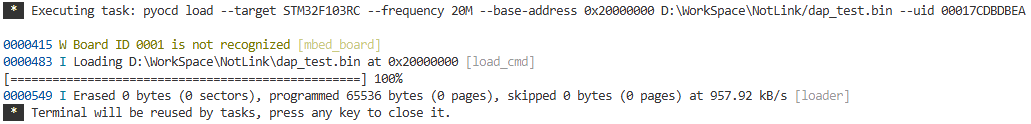

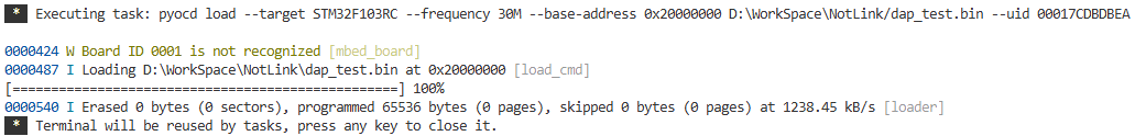

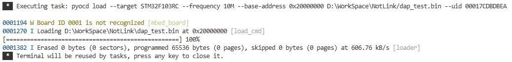

pyocd测速10M,600+KB
pyocd测速20M,950+KB
pyocd测速30M,1200+KB

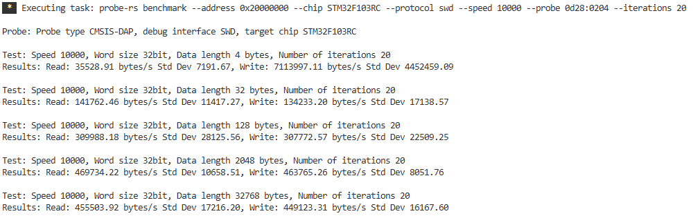

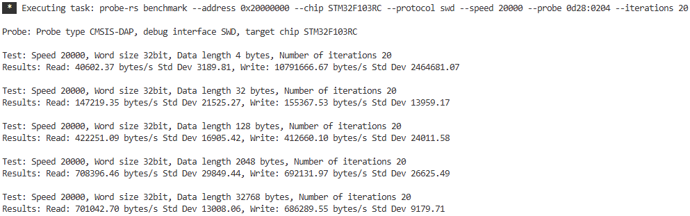

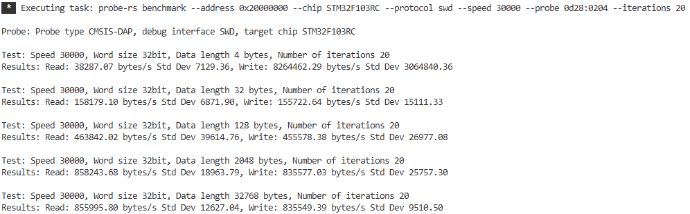

probe-rs测速10M,450+KB
probe-rs测速20M,700+KB
probe-rs测速30M,850+KB
